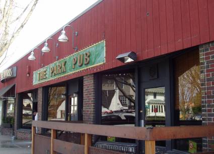

I don't remember the name of the place located on Phinney Ave just West of the Zoo. It was a fire job and we were rebuilding it.
We had to bring everything up to code.
As part of the process, they painted all the burned wood that was still standing with white lacquer to kill the fire smell.
I used to do a lot of these, when you saw on the news there was a fire, I would be out there to replumb it.
On that job, like a dummy I was standing on the top of my six foot tripod ladder.
I lost my balance and fell clear to the ground, landing on my tailbone. Ouch!
What is that, a nine foot butt plant onto concrete?
I went outside on the sidewalk where it was light, to get my senses, and someone comes up and asks what the place will rent for.
I just told him to leave me alone. I had re-dislocated my shoulder on the way down before hitting concrete with my butt.
I was in shock, so I picked up the tools and called it a day. I didn't trust myself to work with power tools until my head cleared.
I guess I should find the place and have a beer.
It might be called the http://www.theparkpub.com/
