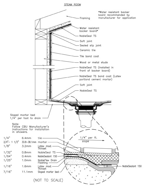

NobleSeal TS Cross section - my favourite specification drawing

But, let's take NobleTS which requires their sealant on the 2" overlap seam (they have two different ones, but let's take the more commonly used one). 10.3oz tube will make about 10' of seam at a cost of $25.15 based on the retail price at Noble's web store. Kerdi uses the same 2" overlap, but uses the same thinset as used to bond it to the substrate. 10' x2" seam is about 1.66sqft. A bag of say DitraSet covers somewhere between 150-200sqft at the retail cost of about $17 (price on any of these things varies, sometimes a lot), and would use about 1/100th of the bag. So the same seam that cost $25.15 with NobleTS and NobleSeal 150 costs about $0.17 with Kerdi.
They both pass all of the tests for A118.10 for a waterproof shower assembly. They are both good products. They each have different characteristics and installation instructions. Follow the manufacturer's instructions, and you'll have a reliable product. Which one is 'best' depends on your circumstances and needs.
Any price comparison requires looking at all of the components called out in the manufacturer's installation instructions...the membrane itself is only one part of the equation.
