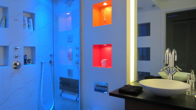

    We have started a fantastic shower renovation here in Yaletwon, Vancouver. The shower will be trimmed out with some great lights and an amazing Dornbracht package.
    We shut the water off to the condo yesterday and removed as much of the condo's old Poly B as we could and installed some new 3/4" supply lines for the shower - both hot and cold.
    My client is concerned that the 3/4" pex pipe will not produce the same volume as say 3/4" copper. The condo has it's own isolation valves so switching at this point is not the end of the world but I have never seen a shower valve roughed in with 1" pex before - that said I have never installed so many German fixtures in one shower before.
    Is there a huge difference in flow rate? I'm sure the valves on the Dornbracht fixtures can not handle this much water as not many homes have this same set up as a condo. I have email Dornbracht and look into this further before proceeding with any more work.

    Measuring water volume through flow testing
    6 gallon per minute GPM [US, liquid] or 22.712 470 704 liter per minute
    8 gallon per minute GPM [US, liquid] or 30.283 294 272 liter per minute
    A personal volume test in my home here in North Vancouver with a 3/4" water line at 104 PSI passing through 10' of 3/4" pex pipe with 2 couplings and 2 1/4 turn 3/4" shut off's produced 1.15 litres per second or
    18.24 gallon per minute GPM [US, liquid] or 69.045 910 94 liter per minute
    I'm waiting on feed back from Dornbracht.
    Who out there has set up a similar test or measured results from their personal project?
    Any insight or suggestions are welcome.

    We have piped the shower with 1" pex to insure the maximum amount of water gets to the shower. We have 40 PSI on the job site the result of a drop in pressure going 12 floors up (pressure in the mechanical room of the building is 70 PSI).
    So if you have 40 PSI and two 3/4" supplies with a few random fittings and you run new 1" pex from that about 12' away again with random fittings and such you can fill a 77 Litre garbage can in 25 seconds flat. OMG is that fast!
    This is a massive amount of water and exceeds my home testing and the capacity of the drain. We have installed to globe valves so we can restrict water flow and tame back this shower system to work with our new 2" Channel Drain from Quick Drain USA.
    I'm very curious to measure the output with the fixtures installed and their design water restrictors working.

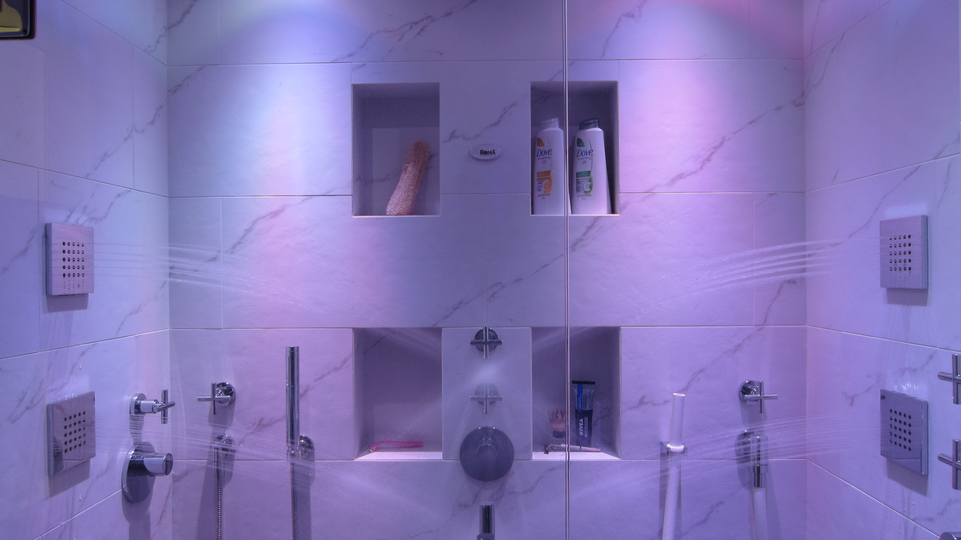

    2009 Universal Building Code - Drain pipe sizes required for different flow rates
    Shower (based on the total flow rate through showerheads and body sprays)
    Flow rate:
    5.7 gpm or less 1 1/2" P-Trap
    Greater than 5.7 gpm to 12.3 gpm 2" P-Trap
    Greater than 12.3 gpm to 25.8 gpm 3" P-Trap
    Greater than 25.8 gpm to 55.6 gpm 4" P-Trap
    This should help you select the proper drain for your next shower package. I have noticed slower drainage rates for the tile insert point drains and linear drains so if your close to one of these limits it would be wise to select a drain with a grill or the next largest P-Trap size.
