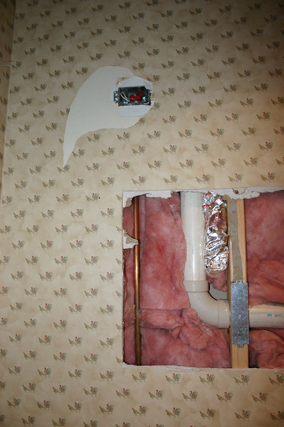

Thank you. I recently reconnected supply to the basement bath and discovered that I get "energized" water when I turn on the vanity light switch. I verified that it's not in my hand by touching hot wire and copper pipe with electrical tester. I plan to remove drywall and look at the romex supplying that vanity light. Since nothing else has changed in terms of elecrical or plumbing in that room, could this problem have been masked by the fact that old pipes were all copper and therefore grounded? The vanity light wall box is metal and is supplied with 14/2 wire with ground. The position of the box is likely that it's touching the copper pipe, but I do not know for sure right now, until I open up the wall

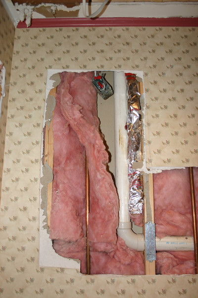

So, I ripped out the drywall and the metal box from the vanity light was definitely touching the copper pipe. Romex wire looks fine now that the box is not touching I don't get zapped nor get any reading on the tester when I touch hot wire and the pipe.
before and after

Good detective work!
Now what was the cause?
There should be a wire clamp on the wire going to that box which prevents the sharp metal of the box from cutting into the wire.
Or perhaps there was a loose wire on the light fixture touching the metal of the fixture, then that was connected to the electrical box via the screws, and then to the pipe?

Is the metal box grounded properly? I can't tell from the picture.

If the pipes and the electrical box were properly grounded, this would not have happened!
Check that the metal electrical box is properly grounded, that the new light fixture is properly grounded if metal, that the ground in the wire is good, and the main electrical system grounds are ok.
