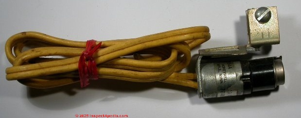

    If it uses a CAD cell flame sensor then you may want to check its resistance.
    And make sure that the fuel pressure feeding the nozzle is correct.

    I am not sure on your unit, but if you changed the nozzle size then you should have adjusted the pressure for the new nozzle.
    If the Cad Cell does not see the flame then it shuts off.
    I think that it is a safety thing and replacing the controller may not fix the problem, you need to check what info that the controller is getting. I do know that flame out will turn it off.
    If you changed the nozzle and did not adjust the nozzle pressure, then in may have not been burning correct.
    I would check to see if the CAD cell is seeing the flame, and that its resistance is correct.
    If you can not measure the nozzle pressure, and adjust it to the proper pressure then you may need a pro to help you.
    Jim knows more about them systems than I do. I think that He is the man for your best help.
    DonL
    Just a guide line;
    "For a properly adjusted burner, during operation, the cad cell resistance should be approximately 300-1000 ohms, but not more than 1600 ohms. A resistance above 1600 ohms signals a problem that should be corrected."

    I found in my stack of manuals were you can pull the CAD cell and check for resistance with room light vs dark. At room light, it's supposed to read < 10k ohm so I set my tester to 20k and it read 3.89 - 4 on the pins at the back of the cell so that checks out. At dark (I put my thumb over it), it's supposed to read > 50k ohm so I set the tester to 200k and it read between 57 and 58 so I believe that all checks out.
    There doesn't appear to be a wiper or anything on my setup and other than the yellow wires on the F terminals on the primary control, I can't get to the ends of the wires on the eye because they're integrated into the unit. I can only see the pins on the back of the CAD cell and those were clean when I pulled it.
    It looks like this (except the eye part doesn't have the silver band at the top and has the numbers 21K1757 and 1024 on it)
    [​IMG]
    Also, when I made it call, it crapped out again but when the PV and motor (was running, I got 2.7v on the F screws on the primary control). It went in to lockout and still I got 2.7v on the F terminals. After I reset it and all was running normally, I am getting .3V on the F screws.
    As for the motor and all that, I don't have that pre purge. The argo panel gets the call, the PV comes on and almost instantly, I get the big "woosh" of burning flame when all is normal. When it goes into lockout, I am definitely hearing the motor during the 45 second pre lockout period and after lockout. I've also been able to hear it during normal operation so I would say the motor is turning normall at all times, it's just that unless I am starting it by hitting the reset, I never get the "woosh" of ignition.
