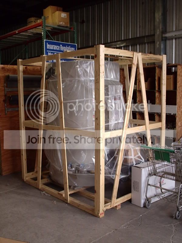

  14. Dunbar Plumbing
    Joined:
    Apr 18, 2005
    Occupation:
    Location:
    Just put one of these in.....set on low and it will heat the entire house in the winter.
    I just had to take a picture at the supply house this morning.
    No two-wheeler for this one. Maybe a fork lift.
    [​IMG]
    That heater is going into a Senior Citizen Care center.
    Gotta keep those bedpan washers piping hot!!!
