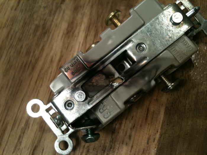

    A word of caution to anyone trying some of the antics outlined for testing circuits found posted on this web site.
    A general branch circuit in any home protected at 15 amps carries enough heat energy to melt metal. If there is enough energy to melt metal wonder what it would do to human tissue.
    http://www.terrylove.com/forums/showthread.php?39524-Wall-outlet-exploded
    [​IMG]
    No one and I repeat no one should ever start using cords and electronic clips trying to connect live circuits to anything. This would be like playing Russian roulette but with a full cylinder minus one instead of an empty cylinder with only one round.

    Yes the picture in the original post (thanks Terry) was a 20 amp circuit but I do hope that everyone understands the same thing will happen at 15 amps.
    The purpose of the picture is to show the amount of heat that will be allowed to flow for around two seconds.
    A rule of thumb one can use to figure the amount of current that any breaker will allow is six times the number on the handle for 120 cycles (two seconds). This means a 15 amp breaker will allow 90 amps and a 20 will allow 120 amps for two seconds before tripping.
    This trip curve is built into all breakers and time delayed fuses. For more information see 430.248 and 430.251(A) of the NEC. Let’s use a 5 horse power single phase motor at 230 volts. FLA (full-load amps) in 430.248 equals 28 amps. Now in 430.251(A) LRA (locked-rotor current) for the same motor equals 168 amps or six times the FLA.

    Look at the receptacle that Terry posted in the first post of this thread. Do you think that there was flying debris from this arc? Do you think that there was a bright flash? This was the very same thing as an arc welder in use and the danger to the eyes is the same. The danger of flying debris is the same such as those little red things we see coming from the point of weld. This can easily set a person on fire and had been documented as doing so.

    That is a bad connection over a period of time. No one is going to touch anything too long before saying "OUCH, HOT"!
