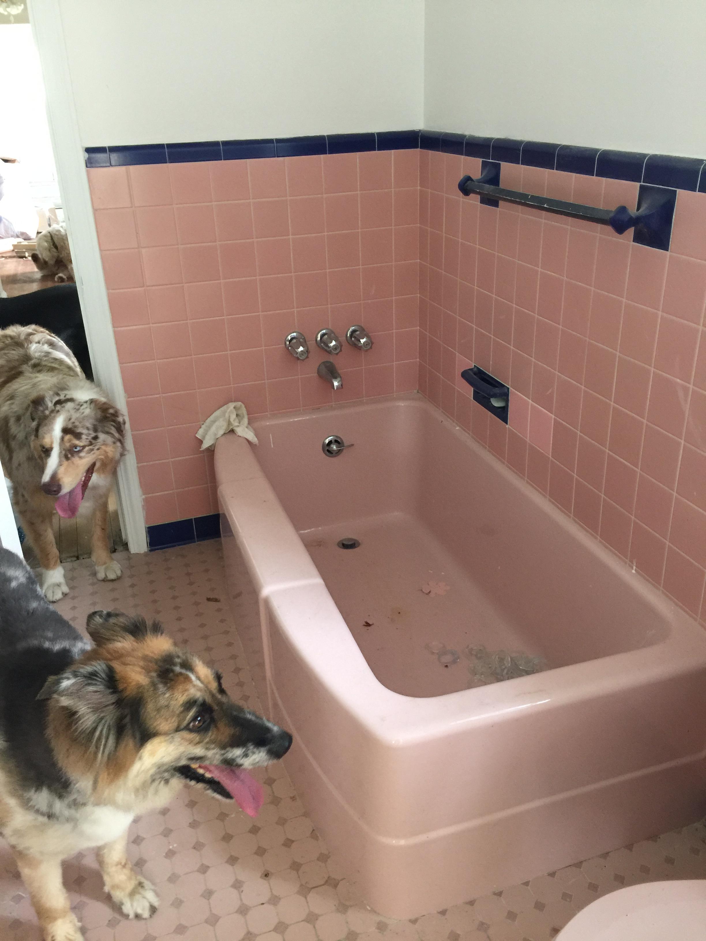

I'm updating a bathroom last updated in 1940. At first I thought I would replace the old cast iron tub since it's pepto-bismol pink, and I want to install a glass bathtub door and adjoining panel. After thinking about it I noticed the tub itself is in great shape with no issues so I thought maybe I could have it professionally resurfaced and then install the glass walls. Here's the catch: The tub was designed so it has a center apron lip that is higher than the rest... I'm going to attach a picture, because I am sure I am not explaining it correctly but it's easy to see.
Before I go down the rabbit hole of figuring out whether resurfacing will hold up under bathtub walls, can I even install a wall/door over this tub with the design as it is? Any input would be greatly appreciated!

Mmmmm. Don't do it.
Putting a glass door track on that not a good idea.
Resurfacing tub, not good either.
Too bad. It looks kinda cool.
Sounds like a new tub with a framed end wall. Either part up or to the ceiling.

Thank you for your thoughts, Terry. I agree that it is a shame. But I can't with the pink, I don't have space for a separate shower and I need the glass walls because I am prone to getting water everywhere.
Too bad it seems to be such a custom thing to have a glass end wall adjoin a sliding door.

It could be done, but it would all be custom and that often means more expensive. As Terry said, resurfacing often doesn't last much more than 5-years, if that. Sometimes you get lucky. While you're at it, since you're using this as a shower, you'll want to change that valve to one with federal required anti-scald technology.
My thoughts exactly. A nice large gap betrween the wall and ceiling would make the room feel larger. I'd only go as tall as you need to for a curtain or shower door, plus a few inches and then a proud cap. I'd probably put a shower niche in too. And maybe lower on the toilet side a TP niche to hold a few rolls.
Glass shower walls look nice but they are hard to keep clean and at some point they will leak.
