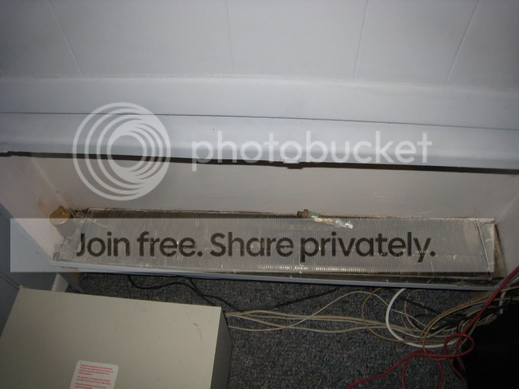

    I have the old style baseboard heaters in my house in rooms that I have not remodeled yet:
    [​IMG]
    They had the old bleeder valves so I installed new ones: Honeywell YHFV180s (the gold round air bleeder in the picture). Anyway, I have always had problems with this one particular heater - the inlet pipe is very hot, the radiator / fins and outlet pipe are not.
    I was hoping the new valve would resolve the issue but it did not. My only guess is that there is some sort of internal blockage that is preventing the hot water from circulating. Eventually I will replace it with the modern baseboard, but I was wondering if there is anything I could do to clean it out?
    The interesting thing is I will get air and eventually water from where the bleeder valve screws in, however it is not hot. I don't understand how that is the case so hopefully someone has an idea.

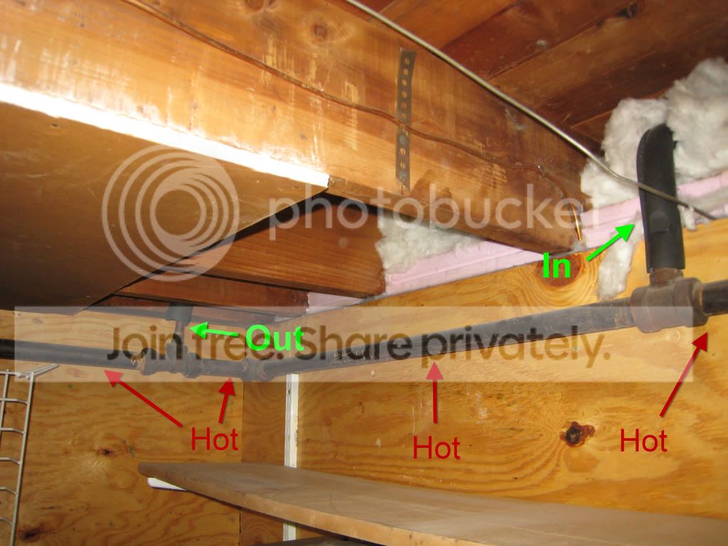

    The initial piping from the boiler is copper, that goes into the main circuit of cast (black) iron which goes around the house, the radiators are piped to the cast iron via copper:
    [​IMG]
    In the boiler room where I can access the cast iron pipes they are very hot. Each radiator is connected by two pipes to the cast iron - an "in" and an "out". The issue seems limited to this radiator - the "in" pipe is very hot both from the cast iron main and directly under where it goes into the fins. The "out" pipe is not hot at all. However, the cast iron pipe that it connects to is.
    I wonder if that is blocked?
    No on / off valve for the radiator.

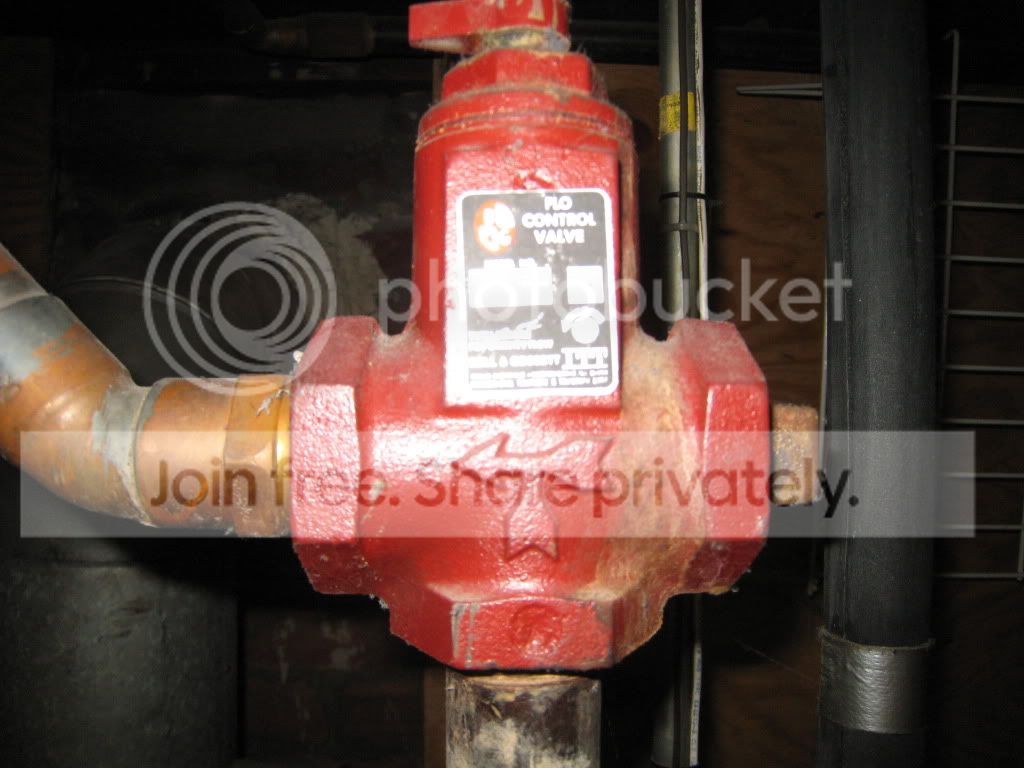

    I am fairly certain of the water direction. On the boiler there is a red valve that says "Flow Master" with an arrow pointing the way I have indicated. That pipe goes into the cast iron which wraps around and then comes to that last radiator, which then goes back into the boiler (I'll snap a pic tonight).

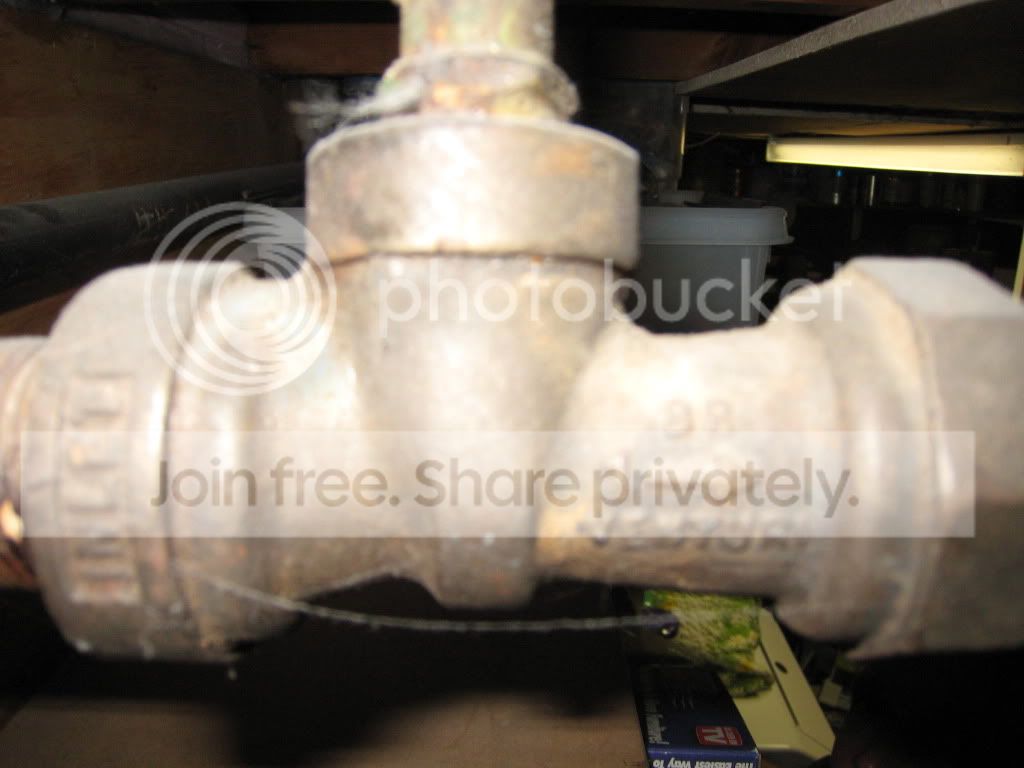

    I stand corrected, it is a valve... I noticed the arrow indicators on one of the other valves and realized that the arrows on this one were behind it:
    This is a picture from the back side of what is posted above:
    [​IMG]
    So the valve is INSTALLED correctly. To add more info, everything seems to be flowing in the correct direction.
    Here is the main pipe from the boiler with the red valve I referred to above:
    [​IMG]

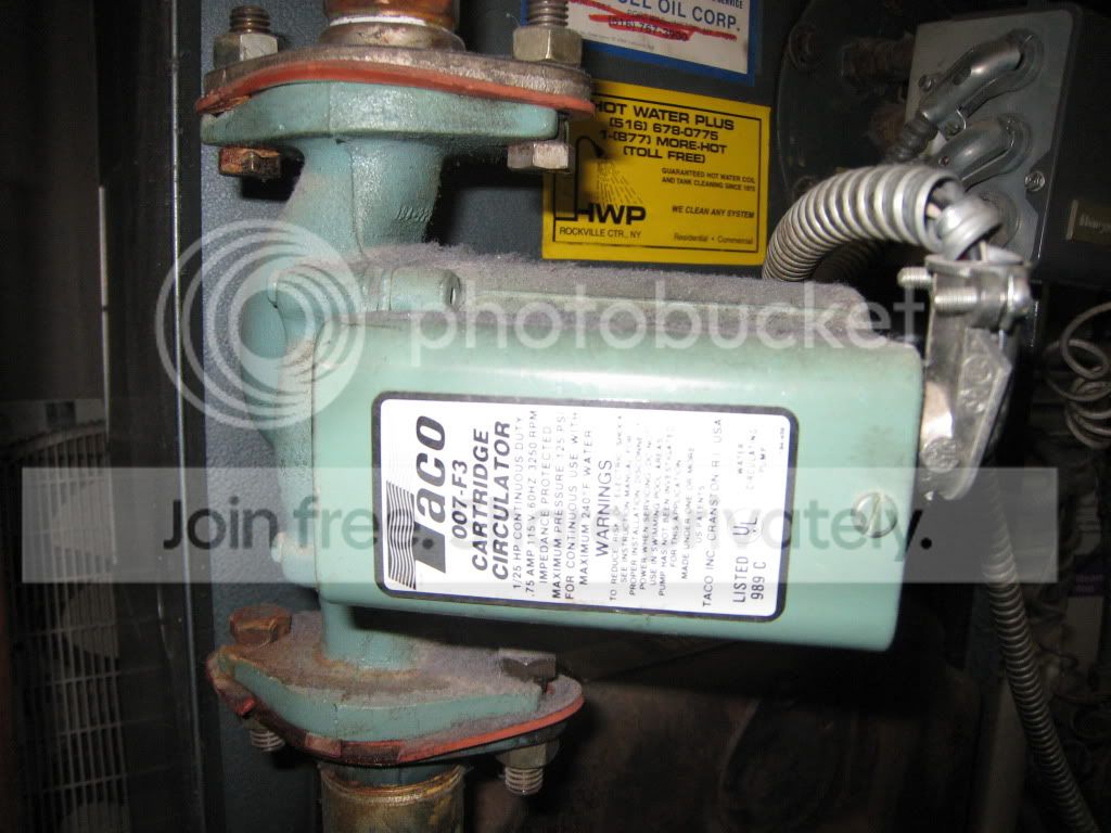

    Which goes into the cast iron pipe, runs all around the house, then comes back to the last radiator (the one not working) and ultimately to this device that seems to circulate the water:
    [​IMG]
    So everything is pointed in the right direction. As mentioned, the radiator "in" pipe is very hot and the outlet is cold so I can only think of one of three things:

    Looking at your pic from the basement that you marked up in/out I think you have plenty of room to cut into the copper just above the tees.
    If I've ruled out all other options here's what I would do.
    cut the copper pipe as clean as possible leaving a 1-1.5" of pipe to reattach to above the tees.
    Then I would test for blockages in the radiator with air then water by going from the in pipe to the out pipe and the reverse.
    Depending on the results there you can also assess the tees to see if they are functioning. I would rig a piece of straight pipe from one tee to the other in the basement. Then refill and test the pipe to see if it gets hot.
    That would I think give you a better feel for if the tees are working as expected.
    You should be able to reattach the radiator with some copper couplers right there in the basement.
    I'm no pro so my methods might not be the same approach others may take, but I've worked on my fair share of boilers that I know the moving parts and what I stated above would be my approach given the info that you shared with us about the problem

    First off that is a B&G venturi Tee and it is properly installed. The venturi tee works on a reduced pressure principal in that an area of low pressure is created at the ventrui that pulls the water through the convector, and those are convectors, not baseboards. There is a slim chance that the convector is plugged but I doubt that is the issue. More likely is that the venturi inlet ( to the convector ) has some crap in it. You could try back purging the loop or cut the copper right at the tee and run a wire down to clear it out.
