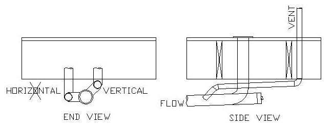

In my view, a horizontal vent cannot be connected to a drain line as per the example to the left, but must be vertical -- any angle 45 and above. As to the connection point on the drain line, it should be downstream as soon as the drain has made it's turn, see drawing to right. This also allows for a clean-out at the end. I'm no plumber, so let the comments fly!

You still have a flat vent there. No vent can run horizontally untill it is 6" above the flood level rim of the highest fixture served. Doesn't matter if it comes off the top of that horizontal or was rolled 45 degrees up, you still need to keep on going up untill your are above the flood rim.

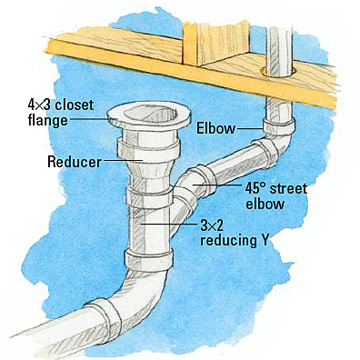

Hey folks, I realize this is a bit of an older thread, but I am sort of in the same situation here. I'm moving a toilet across to the other side of a bathroom during a remodel (about 10' from the main stack where it was previously tyed into the drain stack).
This puts me in the position of trying to vent the toilet through the wall behind it, while draining across the underside of the floor to tye the drain into the stack.
This picture keeps popping up on the interwebs everywhere, and I thought something like this looked promising, except that it looks like this setup has a short horizontal run before it hits the wall, then goes vertical.
Any thoughts? Wondering if I was able to just take that wye straight back to the wall, and omit the horizontal run in this image if that would work? Admittedly that might put the drain quite low into the basement.
Thoughts? I'm still struggling with how I might do this.
