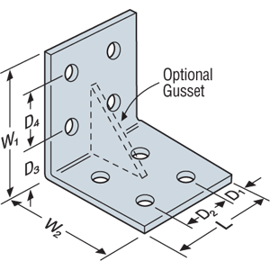

    I am istalling a 6 ft., vinyl fence around my pool area. I am also pouring new concrete around much of the area, so I will be able to sink the majority of the post in the new concrete. There will be a few places where I'll have to mount the posts to the existing concrete. I was wandering if anyone had a good method of securing a 4x4 treated post to concrete. I will be putting a 4x4 vinyl sleeve over the 4x4 treated post. I am aware of the bracket that you fasten to the concrete, then to the post. Using that method concerns me about how stable the top of the post will be. Any ideas will be greatly appreciated. Thanks, your little buddy.

    Since you are covering the post with vinyl, you could weld 3.5" square x 1/8" wall steel tube to a base plate and bolt the base plate to the concrete with really good anchors. The steel tube is the same dimension as the 4x4 posts.
    You might be able to get less expensive pipe and put spacers on it to fill out to the 3.5" square dimension.
    If you have a very good concrete slab you can use a 6" square base plate and anchor it with a single 5/8" fastener in the center. You would need a long extension on the socket wrench and access down the length of the post. You will also need to shim and grout it carefully to get the post plumb.
    You will need to work out railing attachment details for the steel post but that shouldn't be a problem.
    It will be much stronger than any attachment you are likely to make for the wooden posts.

    http://www.strongtie.com/products/categories/post_bases.html
    I'd use the ABU or the EPB44T. I used the EPB44T and it allowed me to adjust the post to make all of them level, plus both of these have great uplift performance. (we routinely get 60 MPH winds here...) The ABU would be better for your application tho, I think.
    Finally, as Bob suggested, maybe you should look at a steel fence system or a hybrid with steel posts and vinyl rails. Steel posts bolted in 4 places (using a foot plate) would be the strongest...

    Frankly, I don't believe any of those Simpson products are adequate for a 6' fence post. They are for structure posts, and resist horizontal loads applied at the base. I do not think they are adequate for the leverage of a load applied at the top of a 6' post. The weakest link is actually the attachment of the post to the anchor.

    The only way that you can use a Simpson post base is for a corner condition like this where the post is supported north-south and east-west by the railing. http://www.terrylove.com/forums/showpost.php?p=93773&postcount=16
    If you have a straight run post on the concrete you'll need to do what either Jeremiahiii or leejosepho suggested.
