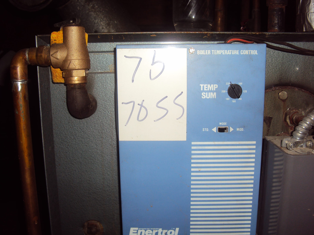

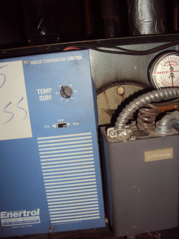

    Hello,
    I am very glad I found these forums, and really hope somebody can help. I recently compiled some data from my heating bills. The single oil furnace does the domestic hot water, and the hot water for the baseboard heat. All laundry is done in cold. The home is about 1300 sq ft with about 1000 of it heated in the winter. We have one bathroom and two of us total living here full time. Between last October and this April, we used 2 gallons of oil per day(~345 gallons). We use a programmable thermostat to set the heat at 68 when we are awake and home, and 64 during the night.
    I thought 345 gallons was pretty good for a winter. However, in the summer, non heating months, we used ~300 gallons. Only 45 less than the winter?! Granted, there are three people living and showering here in the summer, shouldn't it be less than that?
    I took some pictures of the furnace, and an "Enertol" unit. I could not find any documentation on the Enertrol at all online. I did open the Honeywell temp. control(gray) box and set it to 160 Hi/140 Lo, and there was another small dial, VAR, I believe set at 5. (It was at 180/160, 5)
    The Enertrol box has a left, right switch and and temp sum. I've attached photos. If anybody can help with this, that would be wonderful. Without touching the hot water, it takes 3:47 to maintain the water temp(i.e., no hot water is used, when the furnace triggers on, it takes this time to heat back up). I also noticed the water in the line for the baseboard heat(under floor)(but not at the baseboard) stays piping hot even during the summer.

    The Enertrol is an old style analog modulating control that determines boiler temperature by sensing outside temperature. The dial is set at 220 which pretty much overrides the control however for domestic hot water the control has no function anyway. If you want to save money you need to get rid of the tankless coil in the boiler and either go with a gas water heater or an indirect but the boiler looks to be so old that I don't think I would put that kind of money into it. If you really want to save money, tear the old mess out and go with something more efficient and an indirect like a Buderus BE or Logano series or a System 2000

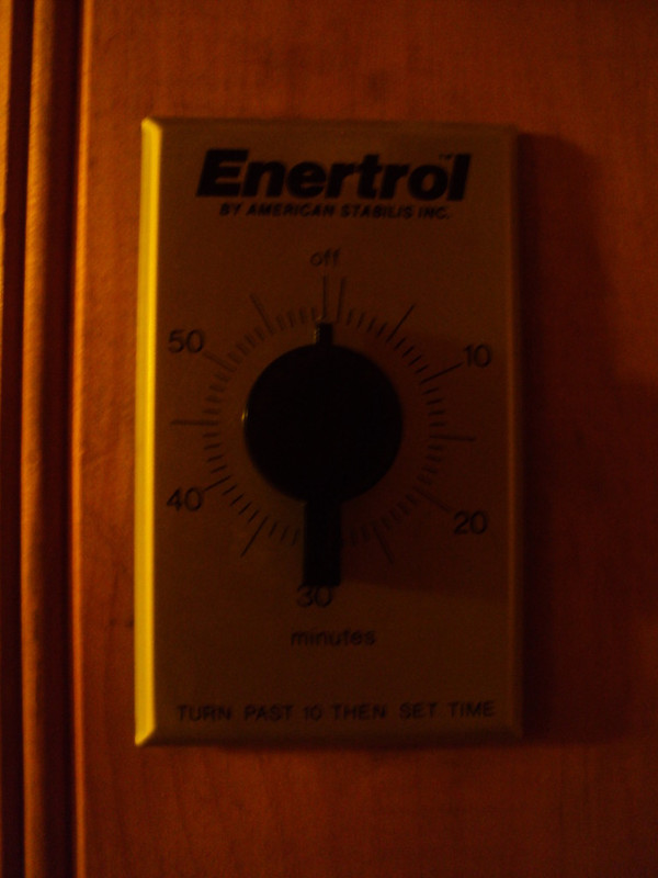

    Thanks to everybody who replied. As a result, I am keeping the setting on 160/140, and have turned the max temp on the Enertrol from 220 to 185, and the water in the shower is still hot.
    Still wondering about the DIFF switch inside the Honeywell box currently set to 5. Also, Any ideas on this knob I have?

    Normally the aquastat is set a 180-200 for the high and 140-160 for the low.
    The high controls the Maximum temperature that the boiler will achieve with the thermostat calling
    The low is an internal thermostat that maintains the boiler at set temperature so that there will be domestic hot water available.
    The differential is the difference between set temperature and any override and it's there to keep the burner from cycling. So with the differential set at 5 the burner will cycle between 155 and 165. Normally it is set to 10
    That dial is a by-pass timer that kicks the Enertrol out of the control loop so that you can have hot water. The Enertrol is wired in series with the high limit. someone probably set the Enertrol at 220 so they would not have to mess with the timer.
    You are currently making hot water in probably the most expensive way possible as you are maintaining the boiler at temperature year around and during the off cycle a lot of that heat in boiler is going up the chimney until the boiler cools and then the burner runs again whether you need hot water or not. Very inneficient. A 40 gallon electric water heater would be cheaper to operate.

    Just a few notes here. First off it looks like the slide switch is standard not mode. That means no ODR function. The setting of 220 changes the curve when modulating the boiler water temperature which is not happening in the standard mode. The 220 setting while in standard does nothing as you would than be operating off the boiler aquastat due to lower setting. These usually came with a timer if installed on a boiler with a DHW coil. You have a manual timer which tells me the Enertrol ordered was for a boiler without a coil and than ooops, and added the manual timer to compensate.
    My guess is this is in standard due to not working anymore.
    The boiler aquastat settings need to be set so the boiler supplies enough hot water. The differential should be set at 20f. This maintaining side of this control has a built in differential of 10f. The water boiler temp drops 10f and starts the burner, and runs until the boiler water temp raises 20f (diff) and shuts down the boiler providing there is no call for heat. Basically it works like this, low water temp - 10 + diff setting. When there is a demand for heat the diff setting is no longer active, just used for maintaining water temperature.
    To reiterate the coil is the most expensive way to heat hot water but if you eliminate by cutting off the pipes do not cap it. You will build pressure and possible create an unsafe condition.

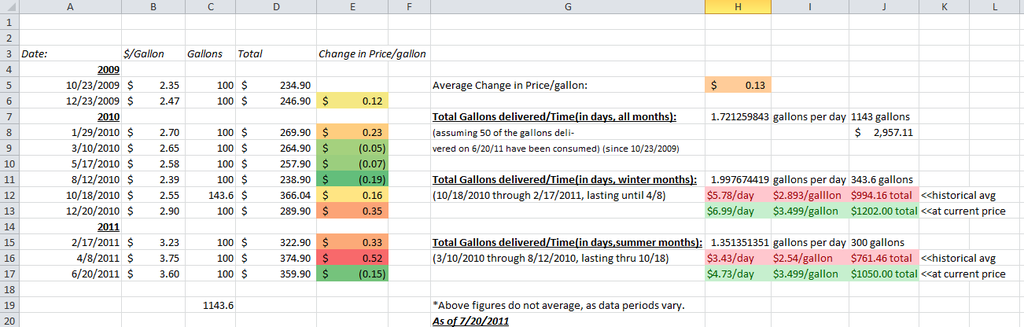

    I made a spreadsheet based on orders for oil. We only order when the gauge has been on empty for about 5-7 days. I've attached it for you. Current differential is at 15. Electricity is 18 cents/kwh delivered here. The tank they were referring to was a propane tank they claimed could not be installed anywhere.
    We have about 35ppm of dissolved solids in our water, but I am sure it has built up as you say. We generally have plenty of HW and would only need to consider something for saving oil or money.

    Maybe I'm not a technician because I also deliver. I had a hard time understanding this and maybe I still don't. The guy that trained me said the low setting turns the burner on and the high setting turns the burner off. I know that is wrong. I turned on the heat leaving the settings alone and the burner seemed to turn off at the low end of the high (10 degrees below 190) limit but my aquastat and gauge are not exactly the same. My understanding is that the hi limit differential is fixed at 10 degrees. I hear heating guys trying to explain aquastats to people a lot and see it on forums.
    Looking at the oil delivery spreadsheet, it looks like 300 gallons got used between 3/10 and 10/18 which is over 7 months. Most likely, some of that in March and April was used for heating so it doesn't seem that abnormal. Maybe you can try lowering the low setting of your aquastat to 140 or 150 if you haven't done so already and see if you still have enough hot water.
    With a gallon of heating oil having the BTU content of about 40.5 kwh, the equivalent price of electricity at 18 cents per kwh is about $7.29 per gallon. At 40% efficiency for the tankless coil, water heating costs might be similar to electric but the boiler should maintain 110 or 120 degrees in the summer anyway so you might as well use it for hot water. With the electric water heater recovery rates at between 20 and 25 gallons per hour, you might not have enough hot water to take the third 2.5 gallons per minute 10 minute shower in a row with a 40 gallon tank.
