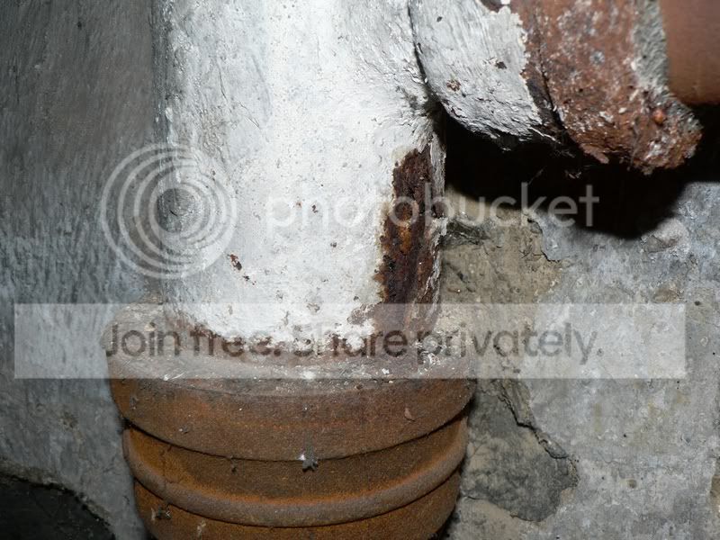

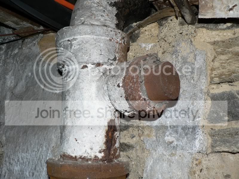

Looks like a short vertical "T" section has rusted through.
There is no leaking and no smell for now, but I figure it's only going to get worse, so I'd like to do something about it sooner rather than later.
The top and bottom pipes have no give. I also don't think the capped "T" will be used in the future but I'd like to replace it with same set up just in case.
What are my options in replacing this piece?

CI is quite heavy, and there are some concerns (and some places forbid) installing pvc with CI above because of the weight on the plastic part. Plumbing like that is built from the ground up, so cutting a piece out of the middle means supporting the upper pieces very well, or it could drop and severely injure you and damage the house.
If you locale allows it, you could crack out back beyond the hubs, and insert equivalent pvc pieces using no-hub connectors and short stubs of pvc. If not, you might crack it out and install new hubless CI pieces, again using no-hub connectors. You might want to consider a pro for this...

The good thing is that the upper section is actually "S" shaped and RESTS on that stone wall, so it will not need to be supported and cutting the "T" out will not bring the house down.
Does anyone have pictures or links to the connectors/fittings that will be required for this job just in case I decide to tackle this myself some day?
