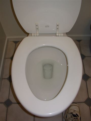

Hi all, first time poster after reading through this thread:
Just had the cadet 3 (2 piece- round front) installed and noticed that the water level in the bowl itself (is that term "water spot"? it's not the water level in the tank) is quite a bit lower than I am used to in other toilets we have around the house (also American Standard). Seems like the water just barely covers the "hole" and comparing to the other picutre on page 2 of this thread it definitely is much much lower. I was wondering if that is normal for the cadet 3? As a total novice, I understand there is no way to adjust that level and am I basically stuck with this very lower water spot, being that my cadet 3 might have a defect? Otherwise, if flushes and refills very well.

It sounds like the toilet is not refilling properly. Your water spot should look something like this:
attachment.php
If not, the toilet is not refilling properly. Look for the white tube in the picture below. It must be inserted into the overflow tube (the large white tube with the blue top) and not kinked. When you toilet flushes, a stream of water comes out of this tube when the tank is refilling to refill the bowl. Watch a flush with the lid off to be sure this is happening.

Thanks a million Tomw- indeed the white tube was NOT inserted into the overflow tube, now my toilet's water spot looks pretty much like the picture as shown (still a tad lower from what I can see).
I noticed that according to the instructions- the water level should be 3/8 (?Inch) below the over flow tube. Mine was installed (by what I now realize is an amateur "plumber" about 1 inch below. I tried to turn the Water Level Adjustment rod but it seems like the top end of it is clamped and won't budge, do I need to move it "out" of the top clamp?
I wasn't realy sure what the instructions meant by turning the rod and moving the FLOAT CUP up or down (please pardon my stupidity), do they mean while I turn the rod, I have to move the cup up (as I want a higher water level) at the same time?

This adjustment is really not critical - you just want to make sure that your level is not so high that it overflows into the overflow tube (in this case, your water will never shut off) or too low and getting an inadequate amount of water for your flush. The 3/8" adjustment American Standard suggests is most likely the level that will give you exactly 1.6 gal (or 1.28 gal) depending on which toilet you have. Right now, you are getting a little less water, but if you are happy with the flush performance - why fool with it?
If you want to adjust it, you just grab the adjustment knob with your fingers (it is knurled) and turn it. It has click detents, so it will not turn easily. Be sure that the adjustment is not at one end or the other of the adjustment range (you should be able to see threads on the adjustment screw). Once you hit the end of the adjustment range, you will not be able to turn it further without breaking something. If you turn it clockwise, it will raise the water level.
Don't worry about what the float is doing while you adjust it, it will not matter. Flush the toilet and make sure the level is where you want it.
