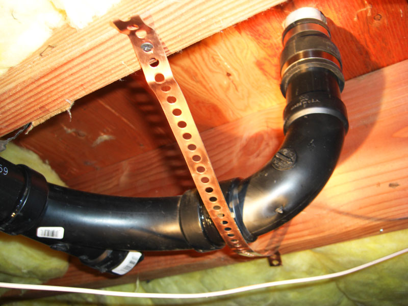

    My cleanout is directly below the floor at the end of the 2" ABS run. You can kind of see it here, on the tee:
    [​IMG]
    Do I need another cleanout somewhere else?

    That cleanout although required is not all that functional...
    I wouldn't use it!
    I would put a cleanout below the sink just above the traps.
    This way you can run water with the snake in the line.
