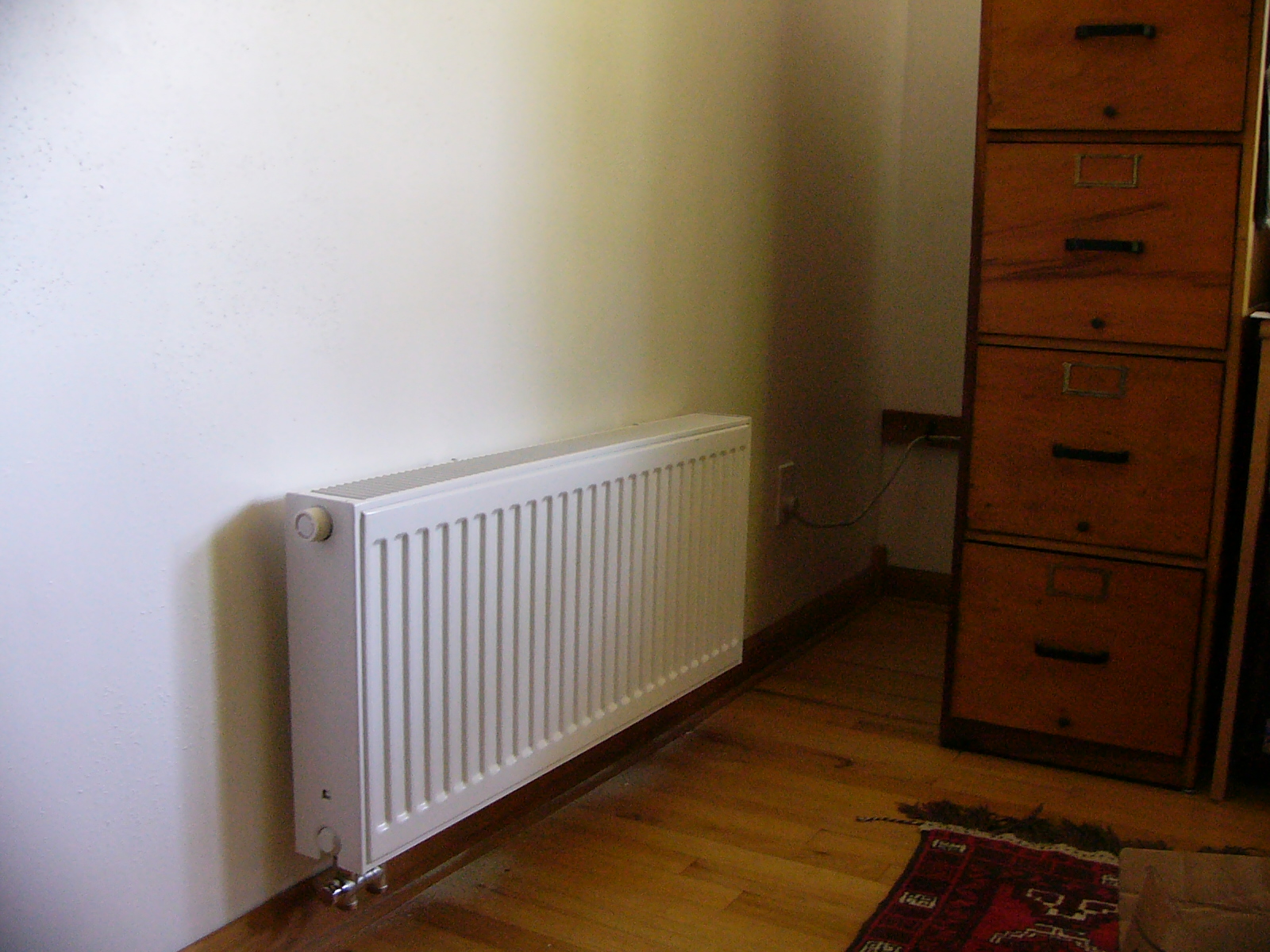

    Assuming your have 5-port manifolds splitting the zone in to 5 loops rather than one long skinny 750' snake you should be able to get reasonable performance out of it, but you have to do the math on how much pump you need, and unless the run between the boiler & manifolds is very short you'd want at least 3/4" to the manifolds. There are many decent radiant designs running with 200', even 300' loops, but they're designed, not hacked, with the right amount & type of pump behind it.
    If you spliced it all into one long you'll have to break it up- that's a lot of pumping head and you won't get adequate flow even with a fairly monsterous pump.
    If it's natural gas rather than propane I'd expect the electric heating to cost 2.5-4x as much as gas-fired baseboards- depends on your actual gas & electric rates.
    Rather than fin-tube baseboards which don't emit a lot of heat at radiant-floor temps, european style low temp panel radiator/convectors can put a lot of heat into a room without a lot of plumbing. Putting a loop with a few of these on it in parallel with the radiant floor (and a ball valve to throttle back the flow to the panel radiator branch so's you can feel at least some heat in the floor) would be more comfortable fix than any fin-tube baseboard solution.

    Like anything else if you can't find them locally you can order via internet and pay exorbitant shipping to more remote AK locations, but I'd think if you're near Anchorage there's hope that somebody stocks them.
    Most will put out about half their 180F nominal rating with 130F water, which is useful for figuring out how much it puts out at radiant floor temps. (You can interpolate linearly from the 180F and 140F specs.) If the zone is keeping up mostly you can probably go with something rated 10,000-13,000BTU/hr @ 180F.
    It's a lot more expensive than fin-tube, but unlike fin-tube it's still putting out a reliable-knowable amount of heat even with sub-100F water. Taller is generally better for keeping output linear with temp at very low temps. (A 24" tall panel radiator has a more reliable output with 85F water than a 12", but even a 12" tall version blows away any fin-tube at low temp.)
