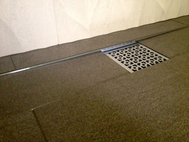

    The best "Point Drain" I recommend to my clients locally is made by a California Company called California Faucets. Their "Style Drain" is made from powder coated cast iron and is the best of the best I have found.
    The one I installed looked like this...
    [​IMG]
    I tweaked the install a little....
